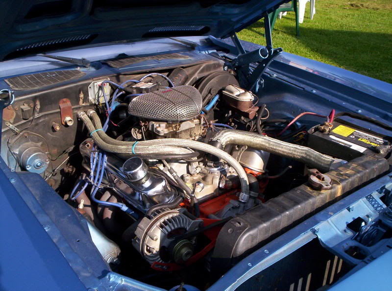

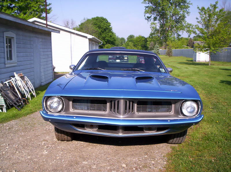

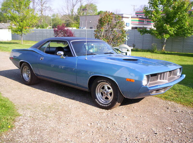

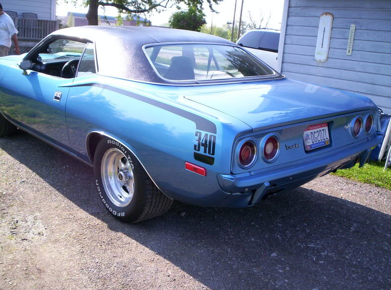

It was never my car... I love the cuda's though. 71 is my fave.
I work for a fried helping him with his biz. He wheels and deals on old mopars. He mostly specializes in 71-74 chargers. I met him trying to get parts for my 73 charger.
Hers pics of the cuda.
That was a hell of a little car.
Even with just a 340 hit screamed!

That's a really sweet 'cuda. I've come to appreciate Mopar a lot more for all the factory support they give by way of over-the-counter performance parts that really work. I've ordered Mopar Performance parts (previously Direct Connection) for another previous car, a turbo GLH-S, and the Mopar catalog had a few hundred performance parts for the enthusiast, many factory engineered.
