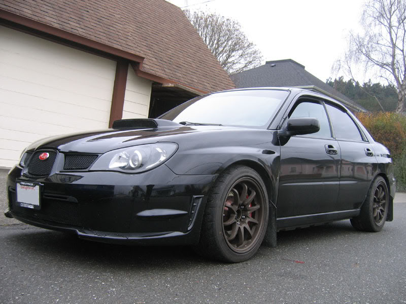

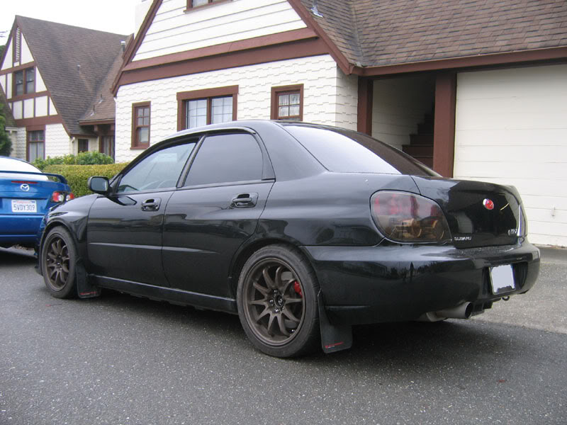

Originally Posted by CaliSuby
So the guy i was suppose to pick up the Teins Coilovers from back out and flaked..
I am trying to lower the front more since the rear is more low. Is there a way to lower the front a bit more to even out with the front? without getting coils?
Here is a pic of my car on RCE Yellow springs. The drop is a little over an inch...but keep in mind that I am on Konis with the D-rex mod that adds almost an inch of travel. The rear is raised half an inch with the Turn In Concepts saggy butt spacers.
The RCE Yellows are probably a bit low for stock struts, but there are a lot of springs available that get rid of a good amount of wheel gap while leaving enough dampening for a comfortable ride.
17x9 +42 offset DPTs. Car is fully functional, and in my opinion low enough to look sweet without riding on the bumpstops
